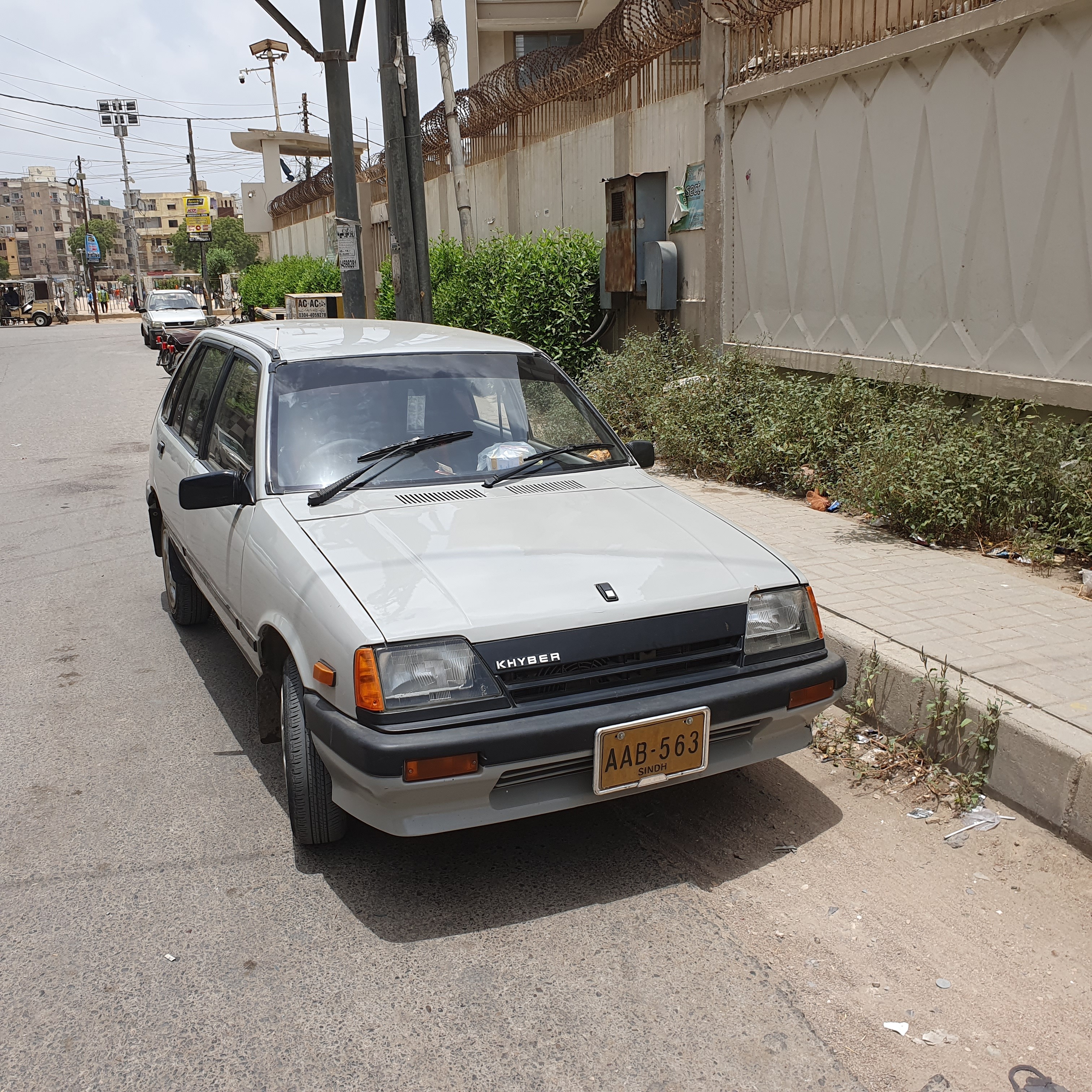

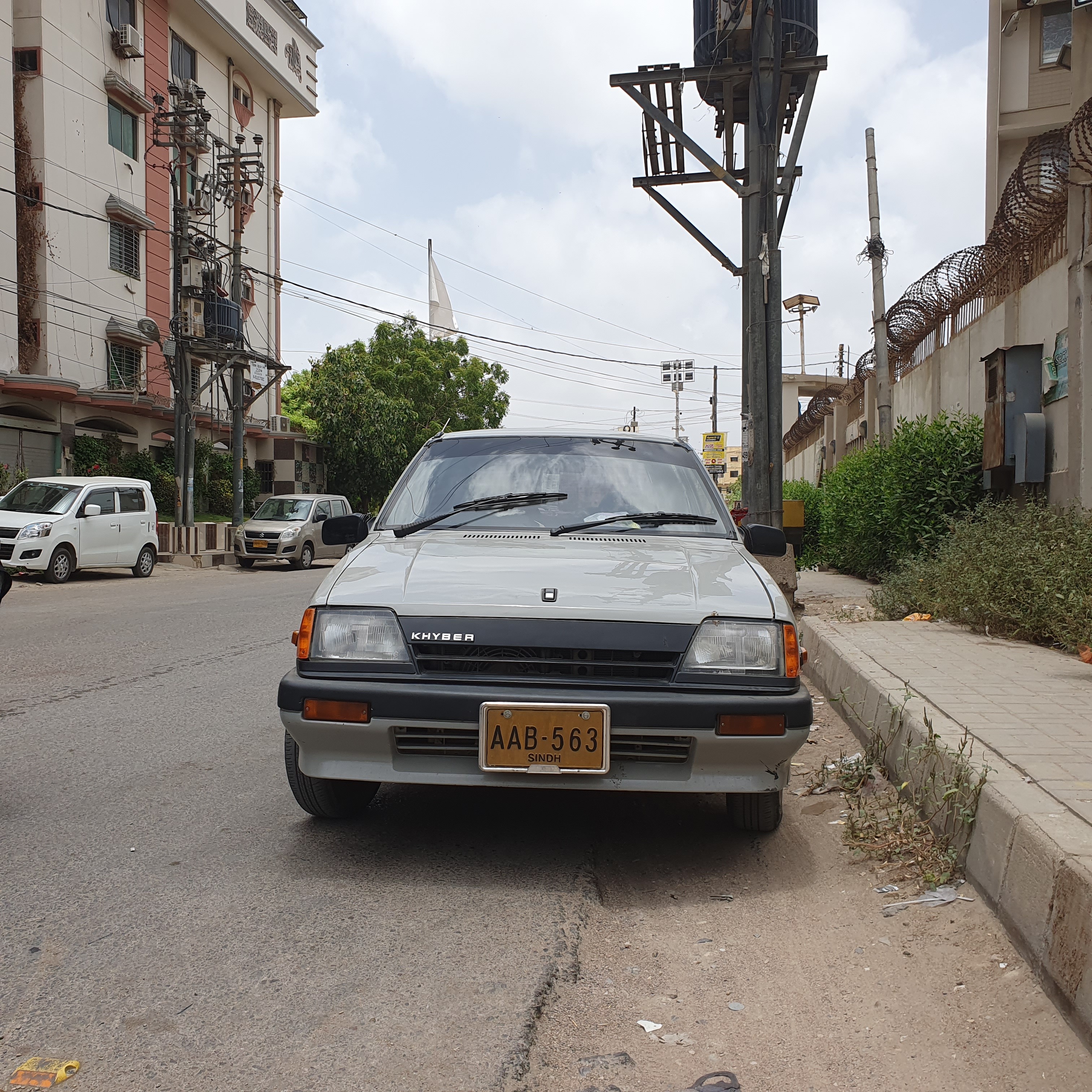

First of all, congratulations on buying Khyber and encouraging your interest in restoring it. Your car is not in such bad condition as I was expected being Karachi car

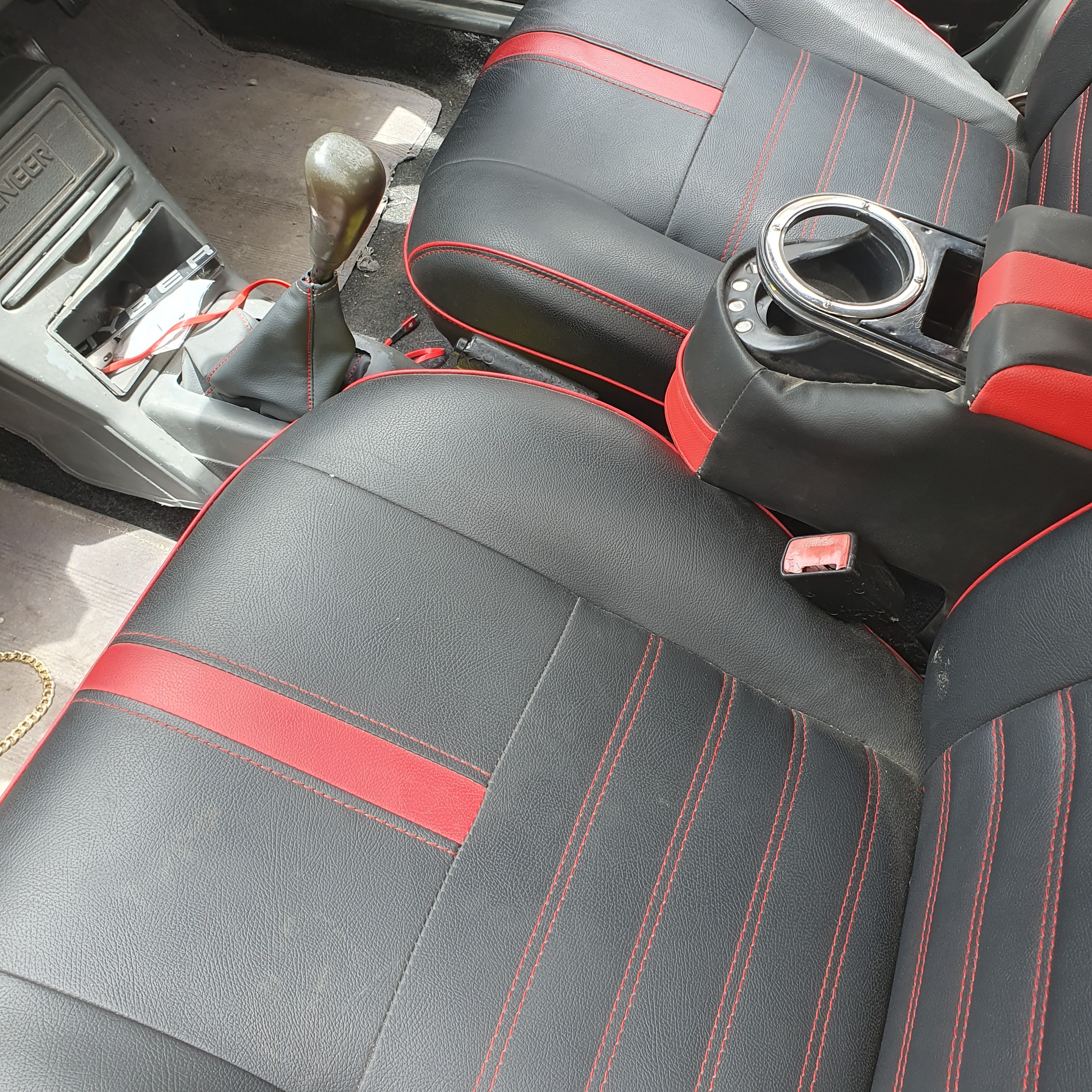

When electrical and mechanical works get sorted, then make seat work upholstery, new foaming, door cards, roof.

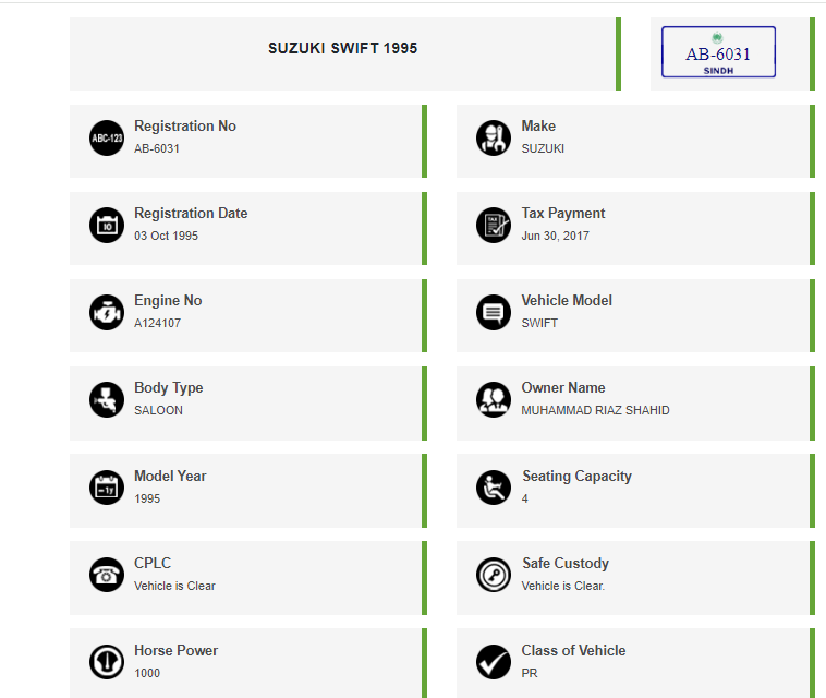

Your car documentation is not good. Do it correct Legally ASAP. Your car's MVT (Motor vehicle tax) is not paid since last 7+ years. Car is on some Riaz Shahid Name. This is serious crime and illegal to keep and drive car on Open Letter and do not paying taxes to Government. Pay tax and Transfer properly it on your father's name immediately.
